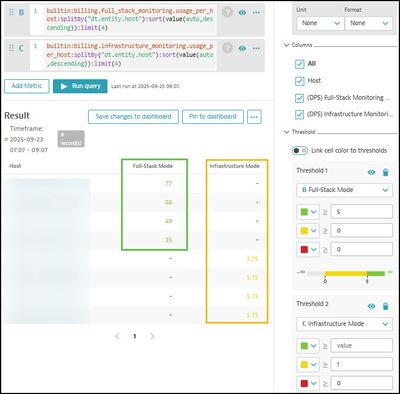

23 Sep 2025 02:18 PM
thx Tomaxp,
Not sure what the "Usage Billing" data gets interpreted as, but I can indeed see those metrics, see the screen grab, are you are hinting at the unit cost (Full Stack technically cost more to run), anything over 5 = Full Stack & anything <2 = Infra Mode? if yes you might be onto something. 🙂
23 Sep 2025 03:04 PM
That metric isn’t directly “host monitoring mode,” it’s the billing usage per host. What you see in the table is the consumption value for each host in each mode.
So the metric gives you the list of hosts and their usage values, which you can then interpret as the monitoring mode.
If you want a single tile showing just the count of hosts per mode, you’d need to either:
pull the host monitoring mode via the Dynatrace API, then push it back into Dynatrace as a metric for easy thresholding on a dashboard.
23 Sep 2025 03:20 PM
Thx Tomaxp,
I think we have something we can use now, thx for that info..
Breaking it up in two (one for Count & one for the VM list, labeling what the Count 'should' be in the title, if those changes, it should be noticed.
To bad we can't set to a # like 147, and anything higher or lower than that 147 count would trigger the threshold to change to Red (can't change the < or > for the colors)...
But this is usable. much appreciated.
