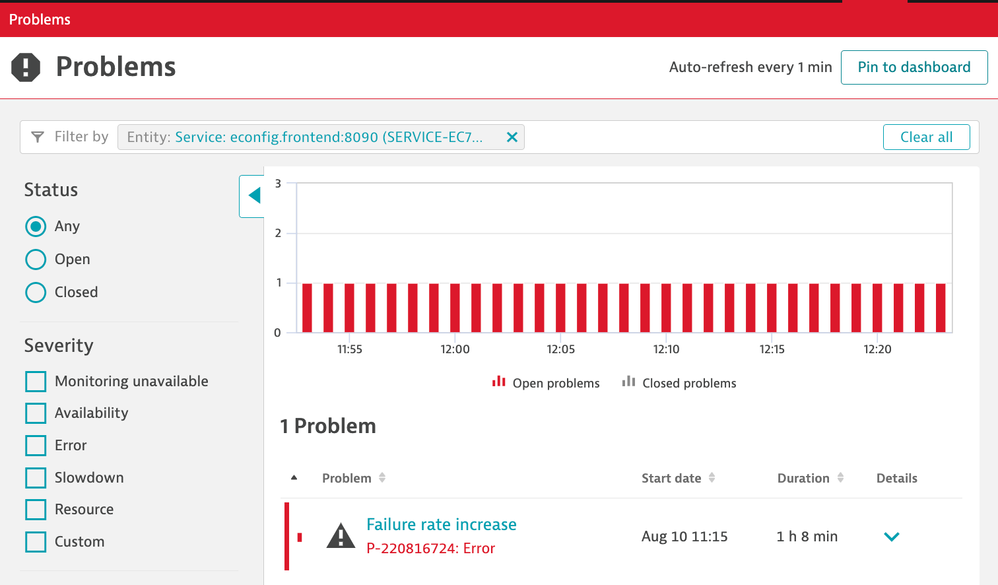

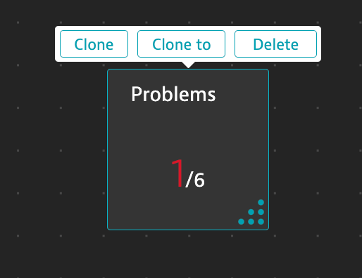

10 Aug 2022 04:26 PM
You can add a problem widget for that specific service using filters in the Problems page, and then use the Pin to Dashboard button.
Does it fits for you?
