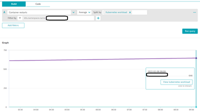

I'm wondering if anybody has figured out how to get a delta value for the builtin:cloud.kubernetes.pod.containerRestarts metric. A few of us are looking to alert on this value but since it's always pulling in the absolute value we find it difficult to set up alerting here. We can use the 'Code' section if there's a way to calculate this delta value ourselves else we're wondering if this can be added to a roadmap.
When looking at Container Restarts within Dynatrace, we see a huge incremental line (count of 600+) so we know there's an issue with this specific event but having a "container restart" value doesn't always mean there's an issue currently. If a container restarts 10 times in 1 hour due to a connection issue and then re-establishes its connection, it'll run healthy but the container restart value for that pod will still be 10 until the pod itself is recycled. If the pod continues to run for another 24 hours after that and restarts five more times, the value will show up as 15.
What we'd like to get instead is the delta value. If we look at the time period when the pod was restarting we should see it going from 1 to 10 but when it stabilizes we'd like to see that pod restart value go zero so when it starts restarting again we can see it go from 1 to 5 instead of it going from 10 to 15 (basically by taking the current pod restart count and subtracting it from the previous value).

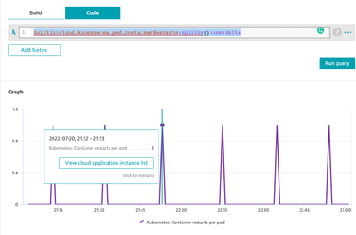

Have you tried the "delta" operator already?
builtin:cloud.kubernetes.pod.containerRestarts:sum:delta
docs: https://www.dynatrace.com/support/help/shortlink/api-metrics-v2-selector#delta-transformation
Looks like:

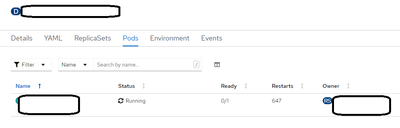

21 Jul 2022 03:49 PM
Hi Florian,
I work with Travis, actually we tried testing the container restart per pod metric using the delta transformation ,but unfortunately the container restart count showing in dynatrace is not matching with the actual count we see in openshift.
For one of the pod we see that the total container restart count is 3 from 19th july to till date.but when we check the same in data explorer its showing different value for this time frame.Could you please help us here if we need to add any other transformation like fold or any other improvisations here.
PFB the details for reference where you can see container restart count is 3 and the data explorer showing other value

25 Jul 2022 06:16 AM
Hi Sriram,
yes, the metric is going to be renamed AND improved. The planned release is with AG 247, which is planned to start roll-out in about one month.
In your screenshot example, my best guess is, that some AG restarts might be the problem. Today, with the current metric, you might see spikes in container restarts after AG restarts. This is due to the fact, that the metric counts total container restarts and the expression calculates the delta to the previously reported total restarts. In case of a non existing data-point (cause the AG did a restarts and didn't report data), the expression will cacluate a delta to zero. So if your pod had already 20 container restarts and at this point the AG restarts, the expression will calculate 20-0 -> showing you 20 container restarts, which is of course wrong.
If you want to digg deeper into that and fix it for this old metric, I'd ask you to talk to our support about it, so they can have a closer look. Honstely, I would recommend to wait until AG 247 and not waste time into a temporary complex solution which is going to be obsolte in about one month.
