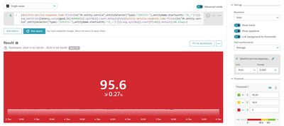

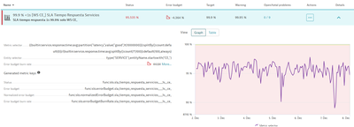

I'm working with SLOs to calculate % of requests with response time < 1s, defined as follows:
In the data explorer:
The SLO using the Dynatrace template is 95,6%.

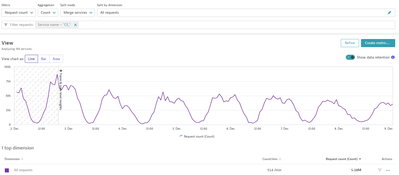

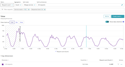

If I perform this calculation using Multidimensional Analysis, the result is not the same:
  • Number of requests with RT <1s: 5.16M
  • Number of total requests: 5.18M
The SLO using manual calculations is: (5.16M/5.18M)x100=99.61%

Hi Elena,
It think this is not the case, because the "avg" aggregation in the Data Explorer is to get the number of requests with response time < 1s. I think they are counted with the aggregation "count" after the "splitby":
((builtin:service.response.time:filter(in("dt.entity.service",entitySelector("type(~"SERVICE~"),entityName.startswith(~"CE_~")"))):avg:partition(latency,value(good,lt(1000000))):splitBy():count:default(0))/(builtin:service.response.time:filter(in("dt.entity.service",entitySelector("type(~"SERVICE~"),entityName.startswith(~"CE_~")"))):avg:splitBy():count)*(100)):default(100,always)

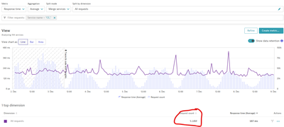

In fact, if in the MDMA I use the "Response time" metric the value is the same as in my previous post:
Please note that my SLO is based in the Dynatrace SLO template for this cases:
Please correct me if I'm wrong.
