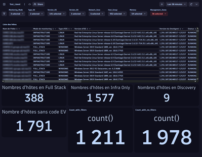

I am in the process of discovering DQL but I am encountering a rather serious problem: I have several filters for a table in my dashboard which are populated with the values ​​of the table. This part works fine but one of my columns may have "null" values. And in my filter, this is not seen, and biases my results.
In the screen below, you can see that I use several filters, with success, but the "Management_Zones" filter does not show all the possibilities because of the "nulls" that may be found there. I did the calculation with and without filter and the difference is significant :
My question is the following: how can we force "nulls" to be named in a specific column? I looked for several solutions but all the ones I tested didn't work.

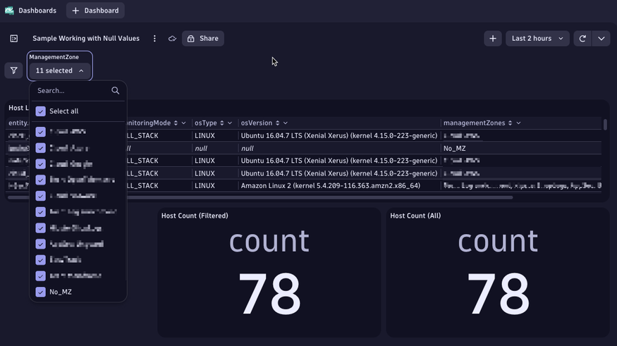

Result when we select all MZ's and also select "No_MZs":
