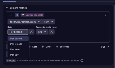

  1. In Explore metrics, you can set Rate → Per second, Per minute, Per hour, Per day

  5. Set Rate → Per second (this is your “RPS” switch)

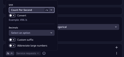

  7. And for a clear axis and chart legend, make sure that you set the unit to Count per second. Go to the Visual tab and into the unit surface to set it.
💡Dashboard hygiene tip: If you label the tile “RPS”, make sure Rate → Per second is set; otherwise, you’re showing “requests per bucket”.
Setting the unit:

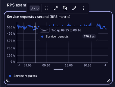

Result (try it on this Dynatrace playground dashboard):
