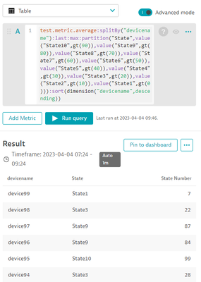

In my example below I'm ingesting a metric thats random from 1-99 and has a device name as a dimension. You can then use partitions and a table view to display each dimension (in your case application) as being in a different state based on the last value.
The expression I used is as follows:
test.metric.average:splitBy("devicename"):last:max:partition("State",value("State10",gt(90)),value("State9",gt(80)),value("State8",gt(70)),value("State7",gt(60)),value("State6",gt(50)),value("State5",gt(40)),value("State4",gt(30)),value("State3",gt(20)),value("State2",gt(10)),value("State1",gt(0))):sort(dimension("devicename",descending))
Hope this helps!
