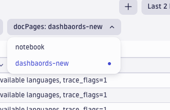

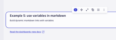

What about creating a code-based query.
I have a simple CSV based example here (Example 5):
I defined a variable on top that has two strings
and in the markdown I use the value in both the text as well as in the actual underlying URL.

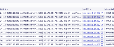

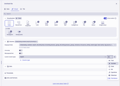

yes use column type + markdown and you get it
set column type to markdown
DQL => construct markdown
and it will look like
pro tip: with dql "concat(..." you can also construct a link with any field in the DQL so its a dynamic link

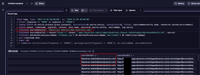

06 Dec 2024 08:24 PM
Thank you Zietho..
Conceptually it makes sense. And I have utilized concat(..) to generate URL. However, I am unable to construct markdown in my DQL the way you have shown. This is what I get, just the actual markdown text , not the text-link as expected. .. furthermore, how would I use the contac(..) in the markdown construction ?  would I need to expose the whole value in a separate field first and then pass it to the markdown construction in my DQL?

10 Dec 2024 05:17 AM - edited 10 Dec 2024 05:18 AM
Has anyone tied and had success constructing Markdown inside DQL to show a link text?
fetch logs
| fieldsAdd myUrl= "[Dynatrace website](https://www.dynatrace.com)"
10 Dec 2024 05:39 AM - edited 10 Dec 2024 06:20 AM
OK.. I figured it out. silly me, I was missing the "Setting the column type" under the Visual section to Markdown type. I don't know how or why I misread zietho's reply about that. And then I used contact in the right place and final result works great. Thank you!
fetch logs, from: "2024-12-03 08:00:00", to: "2024-12-03 09:00:00"
| filter (loglevel == "WARN" or loglevel == "ERROR")
| lookup [fetch dt.entity.process_group_instance], sourceField:dt.source_entity, lookupField:id, fields: {sourceName=entity.name, tenant=dt.system.environment}
| fields tenant, timestamp, loglevel, content, host.name, source=dt.source_entity, sourceName, log.source
| fieldsAdd sourceDetails = concat("[Source Details](https://{environmentid}.apps.dynatrace.com/ui/apps/dynatrace.classic.technologies/#processdetails;id=",source,")")
| filterOut matchesPhrase(sourceName,"filebeat.exe") OR matchesPhrase(sourceName,"metricbeat") OR isNull(sourceName)
| sort timestamp desc
| limit 100
| summarize {errors=countif(loglevel == "ERROR"), warnings=countif(loglevel == "WARN")}, by:{sourceName, sourceDetails}

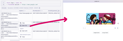

With 1.283 yes. It doesn’t matter whether it is code, build or a query tile or section. As long as a valid https links is the value of the cell we will provide a “open link” cell action. :). So yes

Have you added https://… or http:// we only offer it if the column contains a true links with a prefix of a protocol.
19 Jan 2024 04:02 PM
Yes I have prefixed it with the protocol.
This is the grail query
data record(url="https://www.google.com")
25 Jan 2024 10:33 AM
