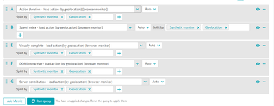

@marco_irmer thanks for your reply
I'm using browser monitoring metrics to be added as a table for a browser monitoring.
Table output is
