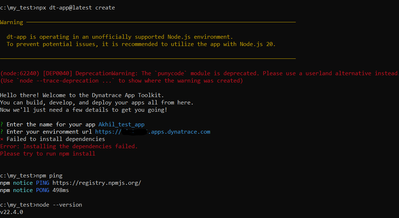

Hi Team ,
I am trying to develop a new app, but it is failing with the error below. Any idea what the error could be?
Thank you in advance,

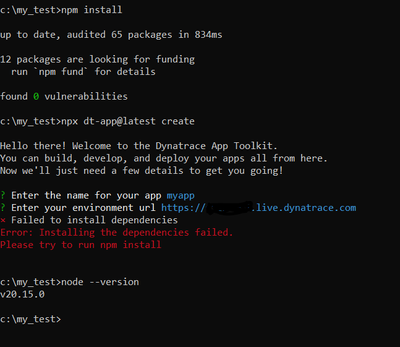

Hi @educampver  @Islam_Zedan ,
Nothing worked. Getting same error even after use v20.15.0 and npm install .
Where I can find which dependencies are failing ?

I now see something I missed before, you must run npm install in the folder created by the CLI. In this case it would be /myapp, please try running npm install in that folder.
Hi @educampver ,
Thank your for your input, I have installed the npm  under the folder myapp  and try to start the  development server it automatically opens the url, but getting 404 error. Anything I missed here ?
