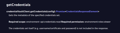

For this case, user needs to have 'environment:roles:viewer' permission and the app needs to specify "environment-api:credentials:read" in the appConfig.ts file so that this app can be run.
This is correct. You can find this information also on https://developer.dynatrace.com/platform-services/services/classic-environment/#accessing-classic-en...

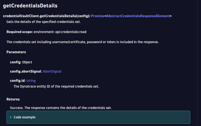

I found one of the Classic Environment API SDK like the screenshot below does not specify the required permission. Does it mean that the users do not need any permission to execute this SDK?
Classic Environment V2 | Dynatrace Developer
Good catch! This is a method which was specifically added to be accessed from apps.
The absence of required permission means that users can only access it when they have the environment-api:credentials:read IAM permission assigned. Their assigned roles (e.g. View environment or Manage monitoring settings) are not taken into account.
