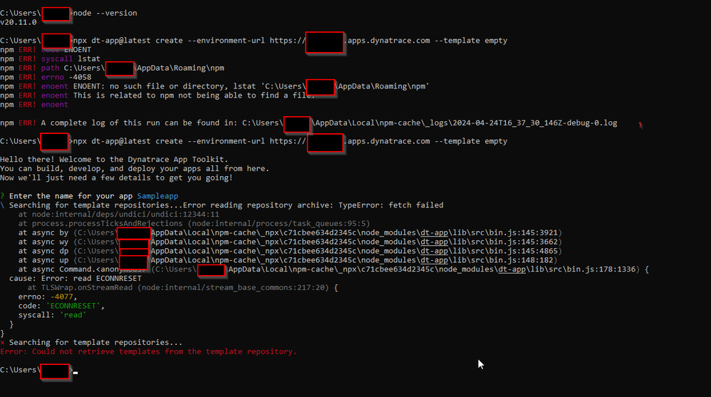

I am trying to build an App using the tutorials available at https://developer.dynatrace.com/getting-started/quickstart
The first error was due to the following line where npm folder was not created after node js installed.
The error is
npm ERR! code ENOENT
npm ERR! syscall lstat
npm ERR! path C:\Users\XXXX\AppData\Roaming\npm
npm ERR! errno -4058
npm ERR! enoent ENOENT: no such file or directory, lstat 'C:\Users\XXXX\AppData\Roaming\npm'
npm ERR! enoent This is related to npm not being able to find a file.
npm ERR! enoent
After manually creating the npm folder,However, The process finally fails with the following error.
Searching for template repositories...Error reading repository archive: TypeError: fetch failed
at node:internal/deps/undici/undici:12344:11
at process.processTicksAndRejections (node:internal/process/task_queues:95:5)
at async by (C:\Users\XXXX\AppData\Local\npm-cache\_npx\c71cbee634d2345c\node_modules\dt-app\lib\src\bin.js:145:3921)
at async wy (C:\Users\XXXX\AppData\Local\npm-cache\_npx\c71cbee634d2345c\node_modules\dt-app\lib\src\bin.js:145:3662)
at async dp (C:\Users\XXXX\AppData\Local\npm-cache\_npx\c71cbee634d2345c\node_modules\dt-app\lib\src\bin.js:145:4865)
at async up (C:\Users\XXXX\AppData\Local\npm-cache\_npx\c71cbee634d2345c\node_modules\dt-app\lib\src\bin.js:148:182)
at async Command.<anonymous> (C:\Users\XXXX\AppData\Local\npm-cache\_npx\c71cbee634d2345c\node_modules\dt-app\lib\src\bin.js:178:1336) {
cause: Error: read ECONNRESET
at TLSWrap.onStreamRead (node:internal/stream_base_commons:217:20) {
errno: -4077,
code: 'ECONNRESET',
syscall: 'read'
× Searching for template repositories...
Error: Could not retrieve templates from the template repository.
The order of execution of the steps can be seen in the screenshot attached.
Node JS Version is V20.11.0
Windows 10 OS 64 bit
Also, Was just wondering if I need to do any steps after Node Js (V20.11.0) is installed ?

More details : Tried both ways with and without the templates parameter.
