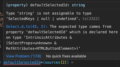

Thank you, Christian - is there any documentation which types defaultSelectedId allows? I get following error when I'm following your suggestion
Just fyi: if I deleted the whole "defaultSelectedId=..." part, it works just fine (source as an attribute for selectedId works).

my selection array (sources) is a string array, but it won't let me set the defaultID:

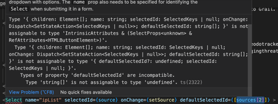

Here is the whole form, maybe I'm making a rookie mistake:
I can't find a solution for my problem so far - even if I follow your suggestion with the [].
