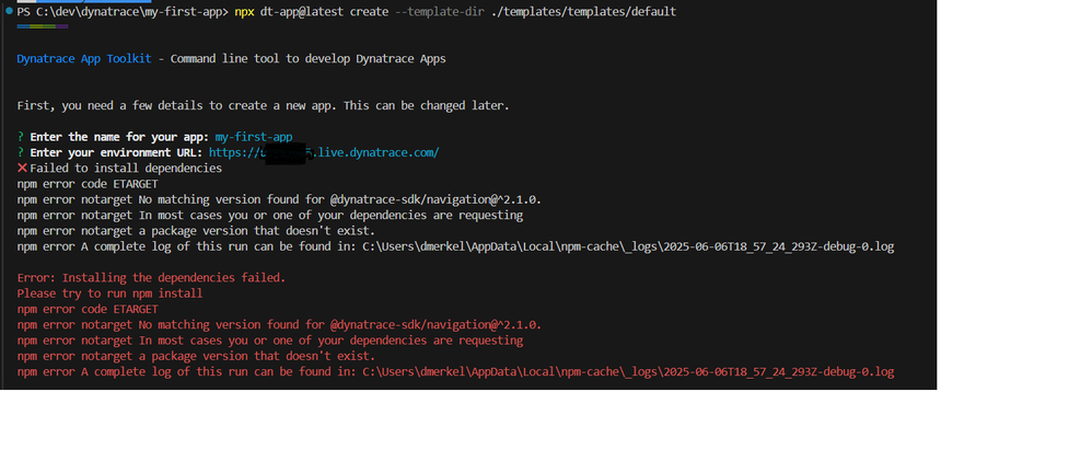

Initially, when attempting to create the new project with "npx dt-app@latest create" I was getting errors stating npx could not retrieve the necessary templates from GitHub.  I ran through the connectivity troubleshooting documentation, and found the workaround where I could manually download the templates and provide the path to these within the npx dt-app command line.  This helped, as the creation process progressed somewhat with this.  However, I am not receiving the following errors:
Error: Installing the dependencies failed.
Please try to run npm install
npm error code ETARGET
npm error notarget No matching version found for @dynatrace-sdk/navigation@^2.1.0.
npm error notarget In most cases you or one of your dependencies are requesting
npm error notarget a package version that doesn't exist.
It seems there is a problem with the dependencies that are being pulled by npx.  Shouldn't the dt-app have the correct config files to resolve this?  How do I go about correcting this?

I removed v24 and installed v22.16 as you suggested.  Unfortunately, I am still getting the same error message:
I have attached both the cmd error and the error log file.

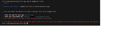

When I run npx dt-app@latest create without specifying the local templates, I get an access error to GitHub.  That is why I downloaded the templates locally and provided the --template option as seen in this convo above.  Here is the exact error I receive when I do not add the template option:
