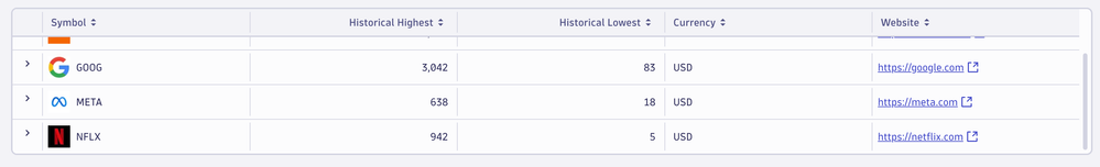

Hi @chris_cho
Can you give it a try? I've tried it already and it does exactly what you want. It makes the header sticky and provide a scrollbar. You can check the screenshot attached.
Thanks
Than you @imsingh
