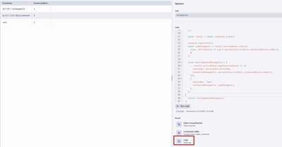

For troubleshooting code snippets in dashboards and notebooks you could use the console.log functionality. The logs can be found in the options side panel

Thanks for the help, I had managed to perform the sum through the use of for and let. Anyway thank you very much for directing with the console.log() for the purposes of analysis.
