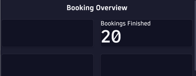

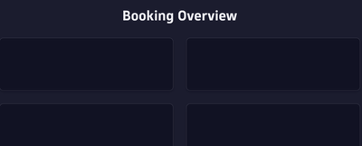

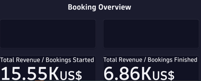

Who can assists, these are the random results I get from step 4:
But mostly:
I used the dynatrace source (-;
Who can help me?
KR Henk
