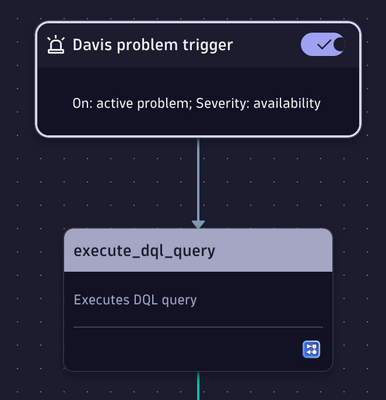

What if the Trigger is event Trigger, for example Davis problem trigger. How do i get the problem ID that trigger this?

Hi @william_cher,
You can access the event payload and its attributes through {{ event() }} expression.
For example:
{{ event()["event.id"] }}
Your AutomationEngine ally!
