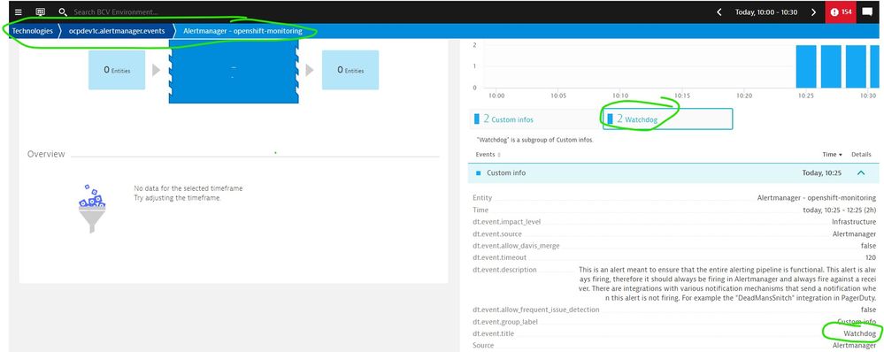

Hello.
On Managed 1.322.58.
We made an OpenShift cluster send its AlertManager events to Dynatrace through extension "Prometheus Alertmanager (v2)." Fine.
We get events on custom device. For example "Watchdog". Fine.
Entity Alertmanager - openshift-monitoring
Time today, 10:25 - 12:25 (2h)
dt.event.impact_level Infrastructure
dt.event.source Alertmanager
dt.event.allow_davis_merge false
dt.event.timeout 120
dt.event.description This is an alert meant to ensure that the entire alerting pipeline is functional. This alert is always firing, therefore it should always be firing in Alertmanager and always fire against a receiver. There are integrations with various notification mechanisms that send a notification when this alert is not firing. For example the "DeadMansSnitch" integration in PagerDuty.
dt.event.allow_frequent_issue_detection false
dt.event.group_label Custom info
dt.event.title Watchdog
Source Alertmanager
Question : How can we alert in case we don't get the Watchdog event ?
Reformulated question : How to create a metric, based on this event, so I can create a metric event and subsequently an alert on missing data ?
I could not find things in the Metric Advanced Search.
