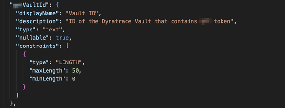

I’m encountering an issue with the appsettings schema (described here).
In my configuration, I’ve declared a text variable and set minLength to 0 to allow the field to be null, empty, or equal to "". I also add nullable: true without success.
However, when testing, the error message indicates that the minLength is still enforced as 1, which seems to be an inherited or default constraint :
Is this a known issue, or am I missing something in the configuration? Any help would be appreciated!

Hi jegron,
you should try to set "nullable" to "false" (and provide "default" value in this case). Then "minLength" of "0" should be considered by the framework. The thing is that for "nullable" fields minimum "minLength" is always "1", meaning in your case where it's true it will create an error.
Let me know if that helps.
jegron
DynaMight Champion
DynaMight Champion
Thanks @haris ! :dynaspin:
