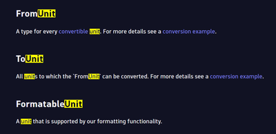

Looking at your link,
Is const formatter: FormatOptions<ToUnit, ConvertableUnit>
Not a better, or am I still missing something?

Hi @henk_stobbe ,
It took me some time to dig into that since the typing of this package is all but trivial. Long story short:
ConvertableUnit) and type parameters (FromUnit and ToUnit). Only types should be documented there.formatter needs to refer to types, so only const formatter: FormatOptions<Unit, ConvertableUnit> is valid, but not const formatter: FormatOptions<FromUnit, ToUnit>
Now the longer story with some background information 🙂 The relevant parts of the type definition of FormatOptions is following:
export interface FormatOptions<FromUnit extends Unit, ToUnit extends ConvertableUnit> {
input?: FromUnit;
output?: ToUnit;
FormatOptions is a generic interface with two type parametersUnit and ConvertableUnit are types provided by the SDK. units.currency.usd satisfies the type Unit, so you can write the following valid assignment: const myUnit: Unit = units.currency.usd;FromUnit and ToUnit are just the names of the type parameters and only valid within this type definitionFromUnit needs to be any type that extends Unit, ToUnit needs to be any type that extends ConvertableUnitUnit and ConvertableUnit are relevant for consumers, ToUnit and FromUnit are just the names of the type parameters of FormatterOptions.16 Oct 2023 01:56 PM
