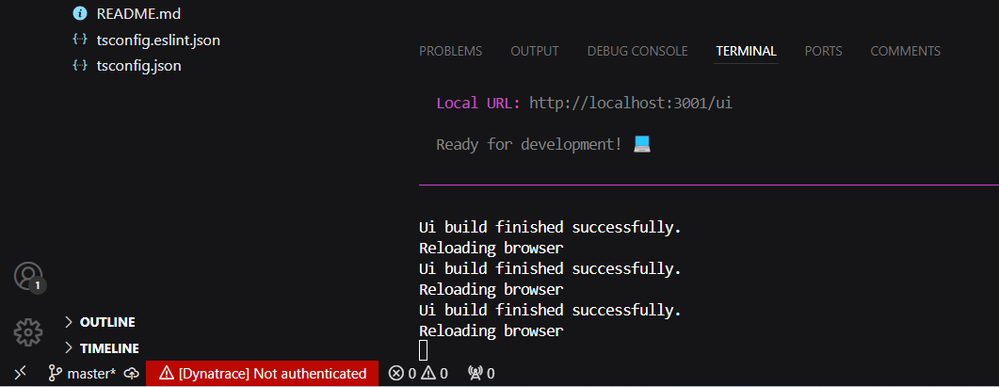

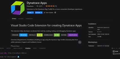

Hi @Tanveermd,
It is a better approach to install the Dynatrace Apps extension on VSCode. Just search in VScode Extensions for "Dynatrace Apps".
Once you create the project, it will show you "[Dynatrace] Not Authenticated".
Not AuthenticatedNot Authenticated

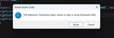

Just Click on it and it will show you dialog like the below to authenticate your self with the dynatrace account.
