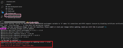

The dependencies package update fails, too:
npx dt-app update

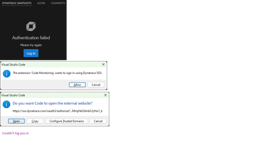

However, in VS Code status bar I see [Dynatrace] Not Authenticated.
Clicking on it, a dialog box is opened asking to authenticate to SSO
Clicking on [Allow] button, it doesn't do anything, no exceptions, no messages, no logs.
By using the extension [Dynatrace Debugger] I am experiencing similar authentication SSO issues.
Trying to login through SSO, in the web browser, I am getting back the message
Couldn't log you in
Even trying to create and use .dql files I am asked to authenticate using SSO. Same it doesn't work.

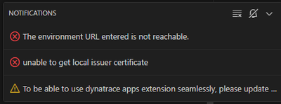

I got a new workstation, and wanted to configure the VS Code extension [Dynatrace Extensions]
Started adding an environment providing the URL <apps dynatrace url>.
After pressing the [Enter] key, I got the messages.
unable to get local issuer certificate
The environment URL entered is not reachable.

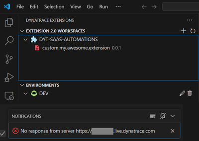

On the other hand, checking again on the old workstation, I noticed that I cannot use the existing extensions Dynatrace Extensions, getting the notification.
No response from server <apps dynatrace url>

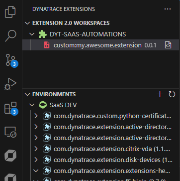

Anyway, in the end out of the blue, I got the new workstation working with [Dynatrace Extensions].
Currently, both application and [Dynatrace Extensions] are working on my new workstation.
