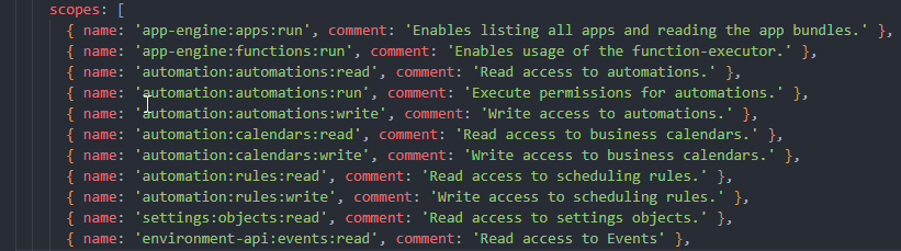

In addition to what Sinisa wrote; apps might require additional scopes that are necessary for them to work properly. Those scopes are defined in app.config.ts. Here's an Automations app example:
More details about the scopes setting: https://developer.dynatrace.com/reference/app-toolkit/configuration/#app-options

That's what I needed! I had to just add:
app-engine:apps:run
environment-api:credentials:read
