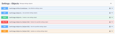

As I see, it appears I can only use "GET" methods to manipulate Maintenance Windows. Are "POST" methods available to create and deploy Maintenance Windows ?

22 May 2024 09:49 AM
Hi @alcq
Yes, of course. In "Settings – Objects" in Environment API v2 you can post an object to create a new settings object.
