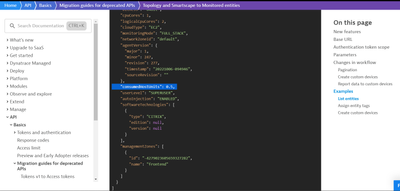

The Official Dynatrace DOC has a page to help with migrating from the Topology and Smartscape API to the Monitored Entities API.
As can be seen here on the Page, Host Unit Consumption is definitely reported on with Topology and Smartscape API, but I'm struggling to see the same value reported with the Monitored Entities API.
