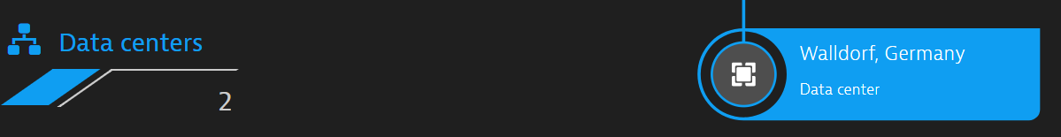

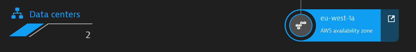

Hi Ray,
I made the same request on my personal environment. I found out that my AWS EC2 machines (in the same AWS availability region and DC) are reporting the same info in the "isSiteOf" field:
"isSiteOf": [
"AWS_AVAILABILITY_ZONE-BA734CACA276B570",
"GEOLOC_SITE-C9B2D39AD8A7FA9A"
Then my feeling is that the GEOLOC_SITE is a unique identifier for the Data Center (since you can also freely modify the hostname, so the IsSiteOf I guess it's also a way of uniquely identifying an host). When I take a look at my windows host (not an AWS EC2) this is what I see
"isSiteOf": [
"GEOLOC_SITE-F9A6CB2B7E82DA37"
And the geolocation of the data center is correctly reporting the area where I'm located (based on IP address):
Hope this sheds a light on what is the GEOLOC_SITE..if you need further information I guess we should involve DEV.
