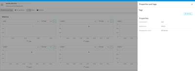

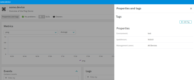

As you see from above the attributes is the metadata you ask for, displayed on every entity individually and extracted, from the metric line.

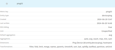

ping00,hostname=some.device 1
ping01,hostname=some.device 1
ping02,hostname=some.device 1
ping03,hostname=some.device 1
ping04,hostname=some.device 1

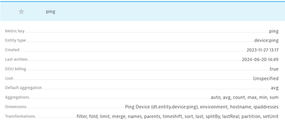

ping,hostname=some.device,ipaddresses=10.0.0.1,environment=test 1
The entity will receive all metrics, and the dimensions will also be shown.
But again if you would like to create an alert based on a metric missing this dimension it will not work.
Below metric with dimensions and one of the metrics without them
