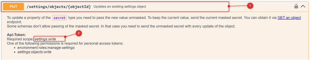

For context, I am using the Settings - Objects API
I'm looking to create an application which calls the Dynatrace API to update an existing maintenance window. When I put the object ID, I get the following 404 error:
"message": "Configuration schema builtin:alerting.maintenance-window does not exist with version 1.0.0."

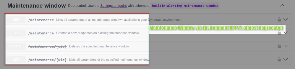

 I can't see any other API which would allow me to update a maintenance window, other than the deprecated one which I can't use for obvious reasons.
Any ideas? Would be greatly appreciated 🙂

Hello @badgerfifteen
As per the latest Dynatrace version, Maintenance window via environment API has been deprecated, so you can use Environment API v2 "Settings - Objects"
Simply you will :
  1. Get the Object ID using token with settings.read scope.
  2. Put The Object ID using settings.write scope, and execute the required actions
As per attached steps (1)
(2)
All the best.
