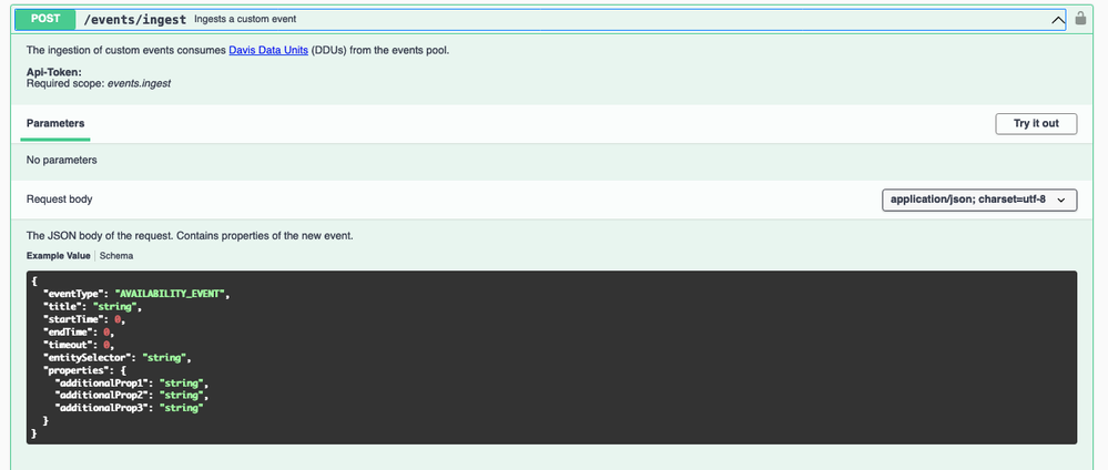

Screenshot 2023-03-29 at 15.49.56.pngAs I understand it, you want to use the API and create a custom event that will then show up in your Dynatrace Problem overview.
