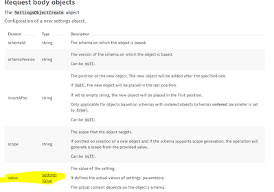

07 Jun 2022 02:13 PM - edited 07 Jun 2022 02:17 PM
Hi @pahofmann,
Payload:
"schemaId": "builtin:process.custom-process-monitoring-rule",
"scope": "environment",
"value":{
"autoMonitoring": true
I am getting below error:
"code": 400,
"error": {
"code": 400,
"message": "Validation failed for 4 Validators.",
"constraintViolations": [
"path": "builtin:process.custom-process-monitoring-rule/0/mode",
"message": "Given property 'mode' with value: 'null' does not comply with required NonNull of schema",
"parameterLocation": "PAYLOAD_BODY",
"location": null
"path": "builtin:process.custom-process-monitoring-rule/0/condition",
"message": "Given property 'condition' with value: 'null' does not comply with required NonNull of schema",
"location": null
"path": "builtin:process.custom-process-monitoring-rule/0/autoMonitoring",
"message": "Given property 'autoMonitoring' with value: 'true' was not found in the schema",
"location": null
"path": "builtin:process.custom-process-monitoring-rule/0/enabled",
"message": "Given property 'enabled' with value: 'null' does not comply with required NonNull of schema",
"location": null
"invalidValue": {
07 Jun 2022 02:32 PM
Well it lists all the values that must be present that you are missing.
You can check the schema via /settings/schemas/{schemaId} to to see all the fields.
Or you can just create a setting in the GUI and then list all the objects from the schema via /settings/objects to check what it should look like.

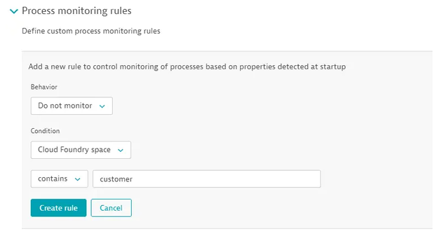

09 Jun 2022 10:49 AM
Hi @pahofmann,
Thanks I am able to create custom process monitoring rule.
Below is the example payload used.
"value": {
"enabled": true,
"mode": "MONITORING_ON",
"condition": {
"item": "IIS_APP_POOL",
"operator": "STARTS",
"value": "Demo"
