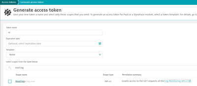

To generate an access token
Select read.logs scope for the token.
