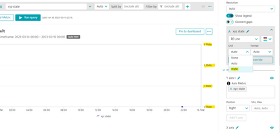

Let me clarify what I'm trying to do. So, I will be using the Metric API and i want to change the metric unit to State.

In the Metric API it looks like the unit is a string not an array, i have done something for VPN states but (personally) i prefer to use numbers because i can apply more aggregations later. But if your metric Unit is States, then Ok, Trouble and Bad" will be values.
14 Mar 2023 08:28 PM
Hi @rdinis
The unit only will change axis label but the metric still will hold a number
Don't think there is a way to send string to a metric
