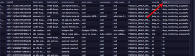

I'm running into this issue currently across a number of k8s clusters. Is there a way to identify the entities with DQL currently? I'm thinking I could create a workflow to restart the applications.
jerry_lobenstei
Dynatrace Advisor
Dynatrace Advisor
I run the API via a Notebook-(Dynatrace SaaS) that will pull the PGI STATE for all process or I can change to just the desired PGI's.   Import the Notebook, Accept and Run.
* This function will run in the DYNATRACE JavaScript runtime via a Notebook.
* For information visit https://dt-url.net/functions-help
