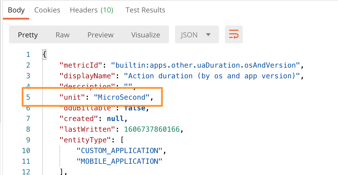

the metric´s base unit is actually defined in microseconds - you can use the metric descriptor API to identify the unit (/api/v2/metrics/builtin:apps.other.uaDuration.osAndVersion)
Hope this helps.
