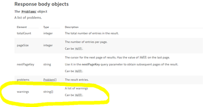

Could anyone here elaborate on what this "Warnings" section is in the Problems API v2 Schema?
Is Dynatrace thinking of allowing Warning Level problems, OMG that would be AMAZING!!!!! Or am i just getting my hopes up.
The documentation provides very little information. Anyone ever use this or see it populated?
08 Mar 2022 03:01 PM
No, this is actually for cases when the API call itself generates some issues/warnings. These will be reported to you in this field so it is not related to 'warning' level problems.
The latest I can find indicates that for this one there currently are no calls you could make that would generate warnings in there but it could change in the future.
