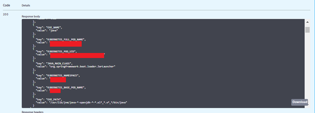

Then I have used thre Get / entities Api with with the Entity Selector Type("Process_Group_Instance"),Tag("Kubernetes"). So I have already received the a list of kubernetes process group list.

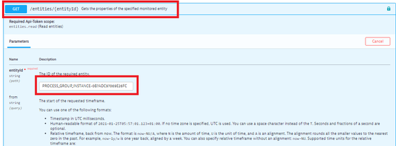

From the list I have picked up a process group instance and checked it with the following Api call: GET / entities/({entityId}:
I have already received the properties:

  • api/v2/entities?entitySelector=Type("Process_Group_Instance")&fields=firstSeenTms,lastSeenTms,properties,tags,managementZones , then filter by "properties"."metadata"."key" start with "KUBERNETES_%"
