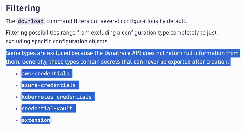

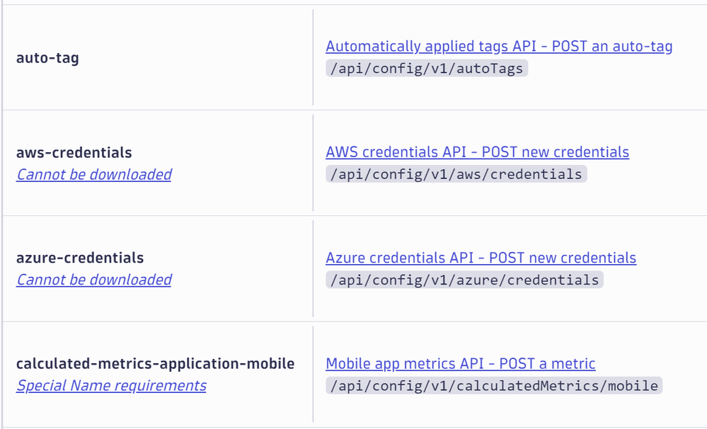

Hi @henk_stobbe ,
You can check link: https://docs.dynatrace.com/docs/shortlink/configuration-as-code-commands#download-filters
Also you can check if api type is supported in this link https://docs.dynatrace.com/docs/shortlink/configuration-as-code-supported-configuration#configs
