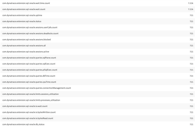

14 Jul 2026 11:14 AM - edited 14 Jul 2026 11:23 AM
Hey,
I have a couple of those hybrid customers as well. (Not a recommendation, as it has issues)
Not possible natively (so not a true solution) ,but I use the following approach in these kind of cases:
You can use the following Data Explorer query:
builtin:billing.custom_metrics_classic.raw.usage_by_metric_key:splitBy(metric_key):names:sort(dimension(metric_key,descending))
Export the results as CSV and then either:
If you use AI, make sure to validate the results yourself, as the categorization may not always be 100% accurate. (Sometimes it takes 2–3 attempts to get the results perfect.)

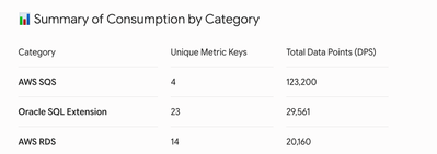

Here is an example of the output:
After AI processing:
