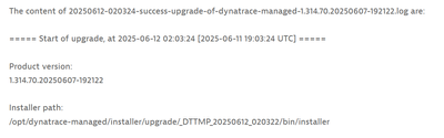

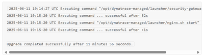

My situation is unique. The upgrade log stated that the upgrade was successful:
But after that, the cluster node is shutting down immediately:
The finding is the cluster node version is 1.314.53. It is strange because the version is 1.314.45 in Mission Control:
While the final destination version is 1.314.70:
Does it mean the automatic upgrade was expecting 1.314.70 but the actual upgrade was resulting in 1.314.53? What can we do then?
