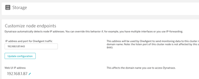

You can define what gets announced in CMC. For each node check out "Deployment status", then "Configure" on each node. At the bottom, check:

The AGs will follow that CMC configuration too, so it should resolve for both OneAgents and ActiveGates.
