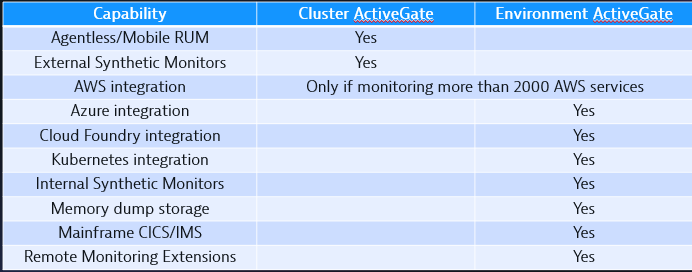

Cluster Activegate also includes Davis Integration, External Synthetics, Dynatrace Mobile App and UFO
Environment Activegate also includes Internal Synthetics

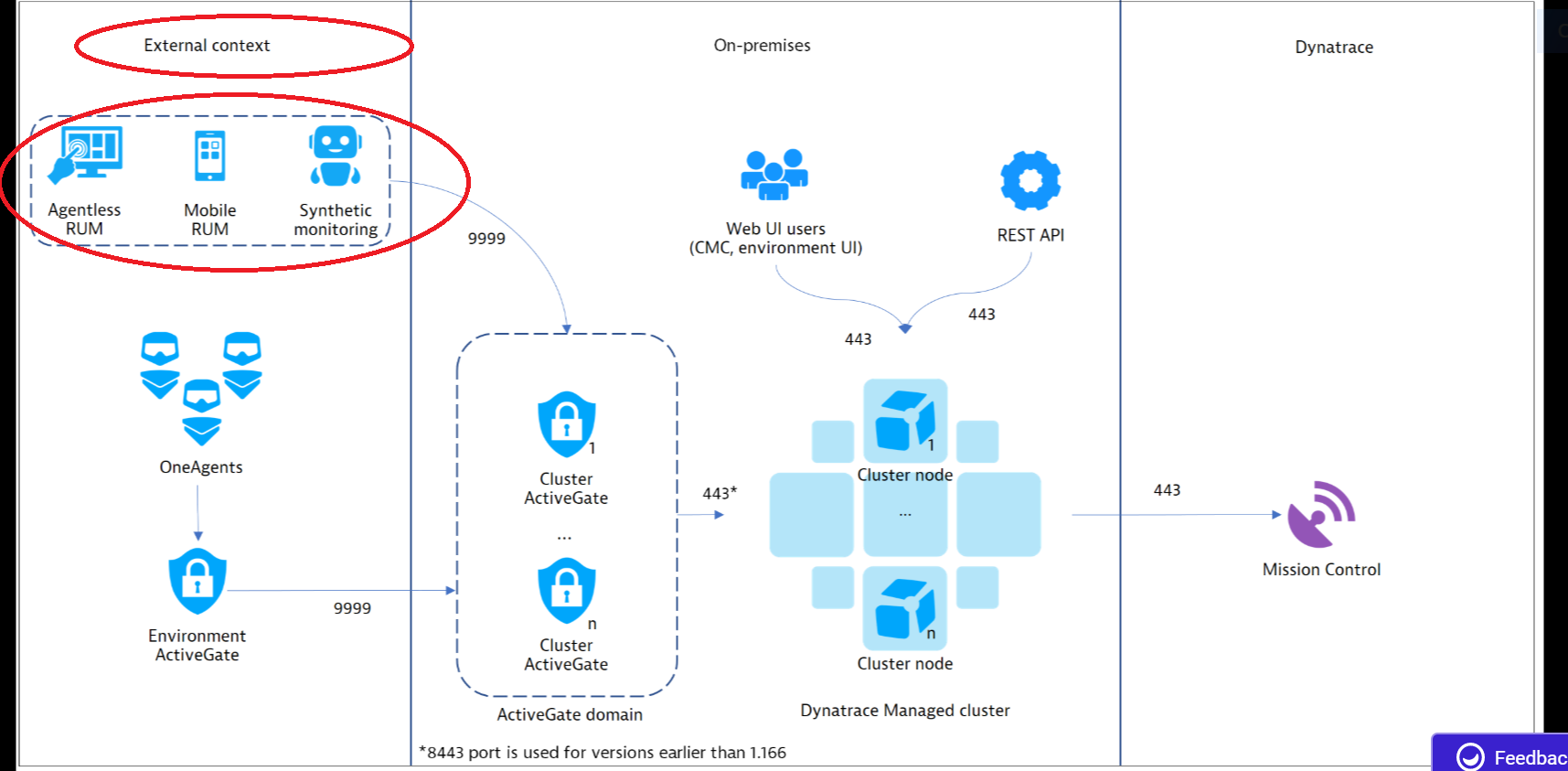

Sorry but Dynatrace reports on this image that Environment ActiveGate is for RUM, Mobile RUM and Syntentic, and this is contradictory with the answer of Mathew.
So, maybe Dinatrace doc is wrong .. or maybe the pictures are in not the best position...(https://www.dynatrace.com/support/help/setup-and-configuration/dynatrace-managed/installation/manage... ) ?
Many Thanks
Hello Jose,
As you can see in the picture you posted, there is an arrow going from that group (RUM, Mobile RUM, and Synthetic) pointing to the Cluster ActiveGate. This communication happend over port 9999.
The vertical line on the left shows communication coming into Dynatrace from an external source. That external source being data from OneAgents, synthetic tests, or information from end users. Depending on the type of data coming through however, will decide if it uses an environment or cluster ActuveGate.

Sorry but ffor me is not clear the different functional use for both (Environment AG and Cluster AG). If you need for instance, private synthetic monitoring... what is the cluster you need to deploy ?
And if you have differents environments "On premise", and considering this picture you have only Cluster ActiveGates... so, there are no options to provide "Environment ActiveGate" functionalities on premise ?

If you have multiple on premise environments, you'll need to use an environment ActiveGate. In case OneAgents don't have access to the internet, you should install an environment ActiveGate to serve as a single access point, rather than opening the firewall for multiple hosts running OneAgents. This approach greatly reduces the effort of managing and maintaining firewall and/or proxy configuration settings.

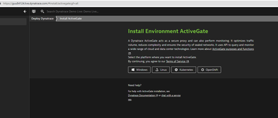

Something isn't right following this table, so if I'm on Dynatrace Saas and not managed can't I have synthetic monitoring? In Dynatrace Saas web UI I can only download Environment ActiveGate

Is there an update on what a cluster Activegate can do compare to en environnement Activegate? I can see cluster ActiveGate running public synthetic monitor.
