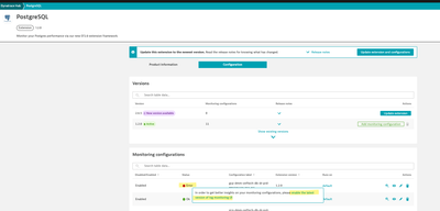

In prod i can see the DB extension logs but in dr i cant. I want know how it would be enabled?
In DR i see something like this

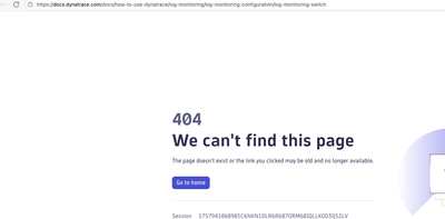

When I click on the link highlighted I am getting 404 page not found

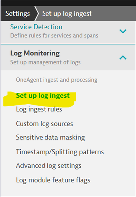

AntonPineiro
Can you go to log settings?

This is from env where i can see extesion logs, suggestion is wrong

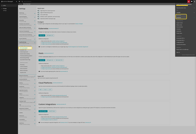

I think your enviroment is using Log v1 and extensions required Log v2. This is not host or extension stuff, it is tenant log version.
Before link can help to inentify if you are using Log V1 vs Log V2.
When your environment is using Log v2, you will be able to see extension's log.
