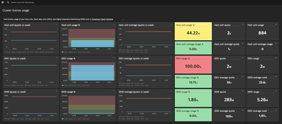

Since Dynatrace Managed version 1.326, new Cluster v2 APIs are available for retrieving host, Davis data, and DEM unit information. For details, see https://docs.dynatrace.com/managed/shortlink/release-notes-managed-sprint-326#track-your-cluster-lic...
In an upcoming release, we will also provide cluster billing metrics that allow you to define alerts in the self-monitoring environment when your license units are running low. Stay tuned!
We will also provide a dashboard for tracking the cluster license usage. See this preview:
@_Alexander_ Thank you! Nice improvement!
Do you know if that dashboard is going to be deployed automatically or do we need to import it manually?
Best regards
It will be deployed automatically to the Local Self-Monitoring environment
