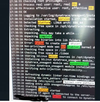

im facing this error while installing oneagent on linux:
error: failed to create dtuser
non-privileged mode was not enabled
oneagent failed to connect to dynatrace cluster
how can i fix this ?
aside, which monitoring capabilities will i loose ?
thank you all in advance

hi @Romanenkov_Al3x we checked but there is a group called dtuser instead. we tried deleting it and creating dtuser  user but we stilll having problem with the installation:
is an oracle linux

@MariettaAlmeida,
From what I can see in the screenshot, my best bet would be that dtuser already existed when you ran the script.
The installation proceeded, but ultimately was not successful because it couldn't connect to AG/tenant.
Please check if dtuser does exist, and solve connectivity issue.
