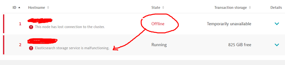

We had a one-node Dynatrace cluster and last week we added a node to our Dynatrace managed cluster so we had a cluster with two nodes. After three days we close the old node, and after 15 min. we saw this error: " Elasticsearch storage service is malfunctioning" in the deployment status screen. When I look at the detail on the node configuration the error looks like this: "Could not establish communication with Elasticsearch server on SERVER at location .....node ip ....  ". At the same time, the cluster is working only on a new node and does not produce any problem when I open the old node. Please help me.

akerimd
Frequent Guest
The problem I'm having still continues, when I close the old node, I get an error on the 2nd node with the (dynatrace.sh stop) method as follows, please help.
