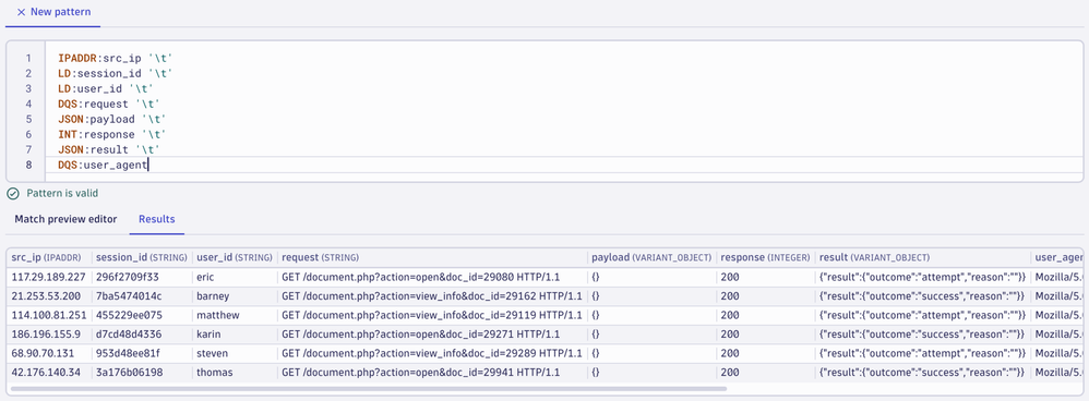

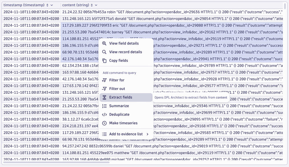

PS! Use the correct field types when extracting the fields to simplify further analysis. This will help you in log analysis later.

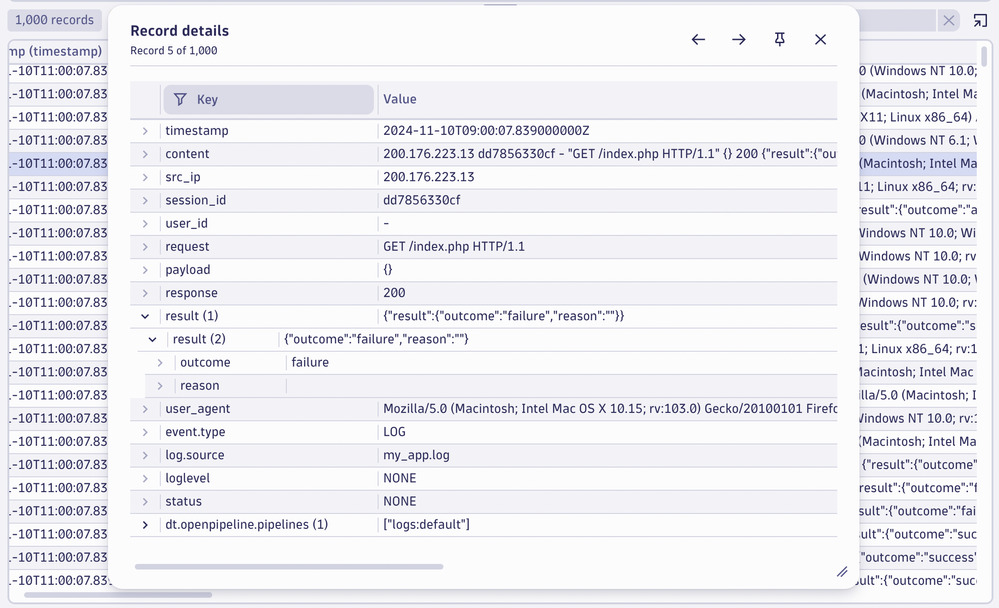

  1. Right-click on a record in the results table and choose Extract Fields. To add more than one record to the DPL Architect, hold the Shift key while clicking on the records in the results table before choosing Extract fields.
  2. Construct a new DPL pattern based on the log format. When developing the pattern, you can see the matching portion of the logs highlighted in the match preview editor section. To see which values are extracted as new fields, check the results tab.
  3. To extract the previously listed elements from the records, use the following pattern:
    IPADDR:src_ip '\t'
    LD:session_id '\t'
    LD:user_id '\t'
    DQS:request '\t'
    JSON:payload '\t'
    INT:response '\t'
    JSON:result '\t'
    DQS:user_agent
  4. Click Insert Pattern to add the pattern to your DQL query and close the DPL Architect.
  5. Click Run to execute the query and display the extracted data as new columns. Double-click any of the records in the results table to open record details and verify if your fields were extracted as expected.
    PS! You can navigate among records in your results using the arrow keys on your keyboard or using the navigation arrows at the top of the Record details modal.

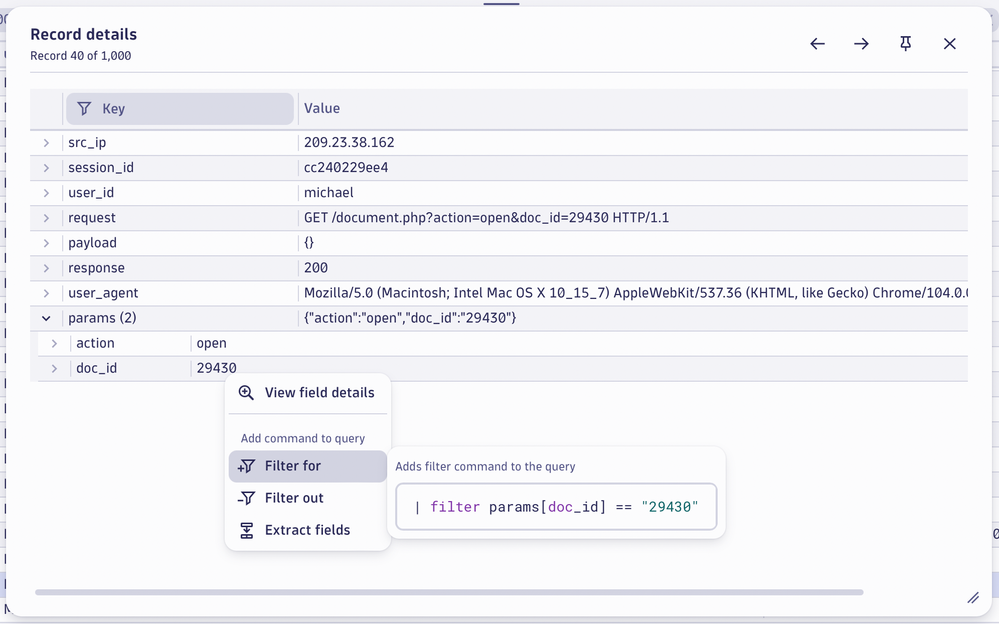

From the logs you can see requests that are related to documents. They all have the following format: document.php?action=open&doc_id=<doc_id>. Continue the investigation by looking into who opened the leaked document.
To create a filter to fetch only the events where the action parameter is open and the doc_id is the ID of the leaked document, follow these steps:
  1. Extract the request parameters into a separate field called params for easier filtering using the KVP matcher. Add the following parse command to the query and click Run:
    | parse request, "LD '?' KVP { LD:key '=' LD:value ('&'|' ') }:params"
    When viewing record details, the new params field is visible and usable along with the other fields.

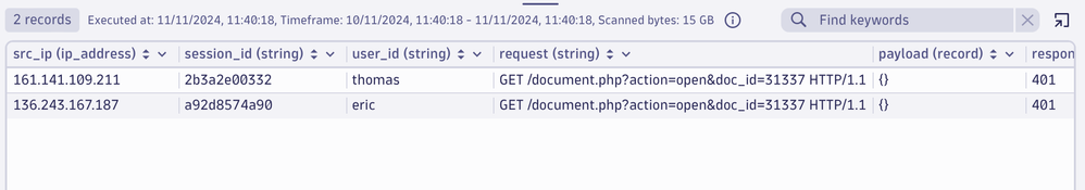

  2. Add the following filter command to see only the events where the document 31337 was opened and execute the query by choosing Run:
    | filter params[action] == "open" and params[doc_id] == "31337"

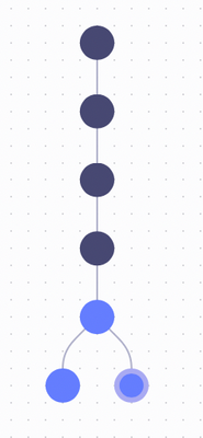

  3. From the results it shows that thomas and eric have tried to open the document.
4. What did Thomas and Eric do?
Let’s dive in deeper and see what else Thomas and Eric have done in Santa’s environment. Follow these steps to set a color for the current node and look into both of their sessions to understand if there’s something suspicious happening in either of them.

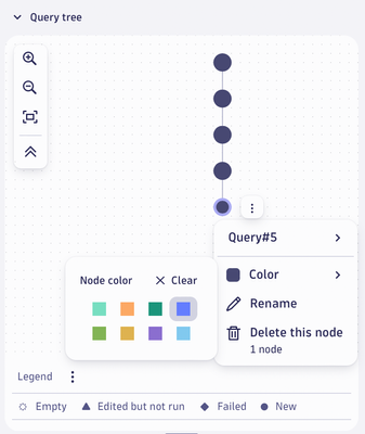

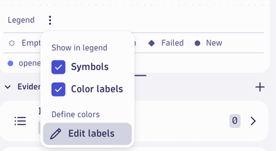

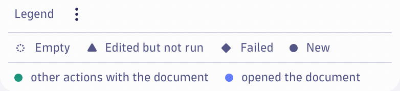

  1. Open the node menu, choose Color and select a color from the available options
  2. Add a label for the color: open the legend menu and choose Edit labels. Label the selected color as opened a document
  3. Make the color labels visible under the query tree by adding a check mark to the “Color labels” option in the legend menu.
  4. Remove the last filtering line (|filter params[action] == "open" and params[doc_id] == "31337") from the query
  5. Right-click on Thomas’ session_id value, choose “Filter for” to add it as a filter statement and Run the query.
  6. It seems that there’s nothing too interesting in Thomas’ activities. Navigate back to the previous node in the query tree and repeat steps 4 and 5 with Eric’s session_id value.
PS! Did you notice that by changing the query in the tree it created a new query branch to the query tree? You can navigate among your previous queries as you to follow different investigation paths so you can keep track of what you investigated and where.
 It seems that neither Thomas nor Eric are relevant to this investigation: they both got HTTP 401 response for the document and from the rest of the logs it seems, that they probably just tried to open the document by accident (missed the right document ID by one number).

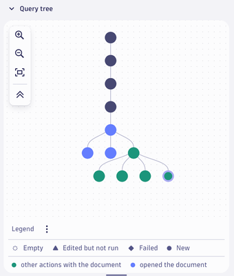

Let’s go back to the previous (the first colored) node to see if we can gather any new knowledge when looking at all the actions done to the document.
  1. Change the filter statement for the query to see all the actions done with the doc_id 31337. Use the following filter command and by choose Run
    | filter params[doc_id] == “31337”
  2. Choose a color for the newly created node and set the label for the color as “other actions with the document”. The legend should look similar to this:
    In the results table you see six sessions (including Thomas and Eric) that have performed actions with the leaked document. Let’s look into each of the new sessions in more detail. To do that, follow these steps:
  3. Remove the last filter command from the DQL query
  4. Right-click the first value in the session_id column and add it as a filter using Filter for and Run the query to create a new node with the results about the session.
  5. Navigate back to the previous node and repeat step 3 with next values in the session_id column. You can skip thomas and eric, since we already went through their sessions.
  6. As a result, you should have a query tree that looks like this:

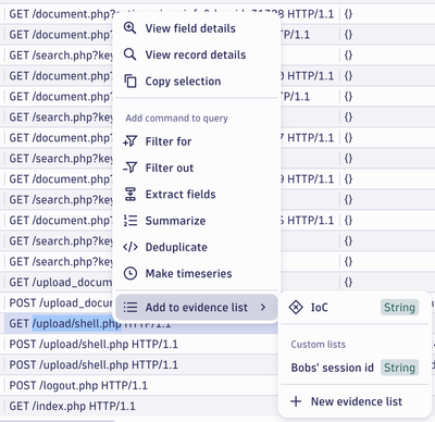

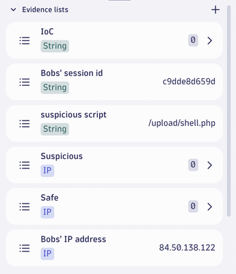

  2. Right-click on any of the session_id values in the results table, choose Add to evidence list, choose + Add new evidence list and name it Bob’s session ID for future reference.
  3. Right-click any of the IP addresses in the src_ip column and add Bob’s IP address as a new evidence called Bob’s IP address.
  4. Select the /upload/shell.php portion from the content column, right-click it and save it as a new evidence called suspicious script.
  5. The evidence in your case should look now something like on the following image:

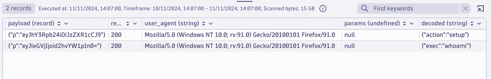

When watching the log records in Bob’s session, you discovered that the payload posted to shell.php script is base64 decoded.
src_ip session_id user_id request payload
84.50.138.122 c9dde8d659d bob POST /upload/shell.php HTTP/1.1 {"p":"eyJhY3Rpb24iOiJzZXR1cCJ9"}
84.50.138.122 c9dde8d659d bob POST /upload/shell.php HTTP/1.1 {"p":"eyJleGVjIjoid2hvYW1pIn0="}

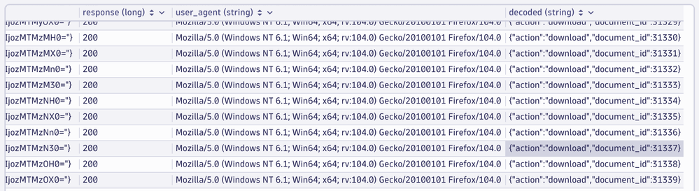

To understand, what is posted to the script, follow these steps:
  1. Add a filter to see only the POST requests to the shell.php script by right-clicking any of the POST requests in the content column and choosing Filter for option from the menu:
  2. Add a new field called decoded to the results using the fieldsAdd command. The value of the field should be the base64-decoded value of the parameter p from the payload value.
    | fieldsAdd decoded=decodeBase64ToString(payload[p])
    After running the query, a new field is present in the results table that contains the decoded command:

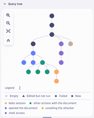

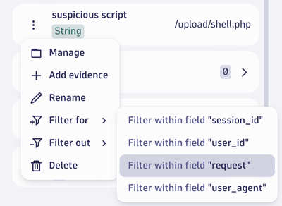

  1. Navigate back to the query node we named app requests in the 2. Section at step 6.
  2. Open the evidence suspicious script menu at the right side panel, choose Filter for and select the column request to apply the evidence as a filtering statement to the DQL query.
  3. Since you already viewed Bob’s session, you can leave his session out. You can do this by opening the evidence Bob’s session id menu, selecting Filter out. Select the column session_id and choose Run.
  4. Choose a purple color for the created node and label the color shell access to make the branch easier to find.
  5. Seems that we found another session that used the web-shell. To understand what was done with the script, let’s decode the payload as we did with Bob’s session by adding the following fieldsAdd command:
    From the results it seems this session is the culprit behind stealing the file (and as we see, not only this file!).

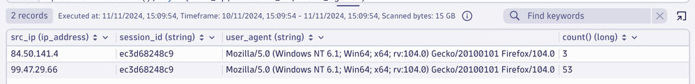

To move further with analyzing this session, let’s do some statistical analysis for the session and see if something stands out. Let’s start by looking at all the distinct user-agents and IP addresses from this session.
  1. Add a summarize command that will aggregate the results based on session_id, src_ip and user_agent fields:
    | summarize count(), by: { src_ip, session_id, user_agent }
  2. Execute the DQL query and analyze the results
    The results reveal two records:
    We have found two IP addresses within the same session with the same user-agent. This might mean that if the attacker was using an anonymizer to hide their tracks, the service might have failed for some requests and might reveal the attacker’s real IP address. This requires some further investigation.
     Let’s save this evidence and continue the investigation by following these steps:
  3. Right-click a value in the session_id column and save it to a new evidence list called attacker’s session ID.
  4. Right-click the user-agent value in the user_agent column and save it to a new evidence list called attacker’s userAgent
  5. Select both the IP addresses by holding down the Shift key, right-click them, and add them to the Suspicious evidence list
