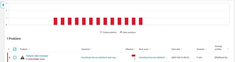

Mr. McHeartFace informs you that Dynatrace has created a ticket for them about a Problem that Davis® AI has detected. It seems that failure rate for web requests in the heartbeat-service peaked somewhere between 5AM and 6AM (UTC). He asked if you could help them to get to the bottom of this.
From the Problem description, you see that a bunch of web requests got an error 503 as a response for some reason, which triggered the problem creation. Can you find out why this has happened?

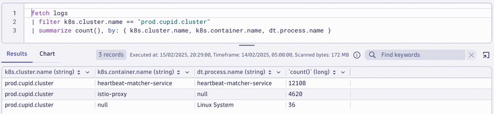

Nice! You got a bunch of logs as a result! Let's aggregate the results to see if all the relevant logs described in the “Background” section are available from Grail.
To do that, add the following summarize command to the query and click Run.
| summarize count(), by: { k8s.cluster.name, k8s.container.name, dt.process.name }
You should see the following result:
Right-click on the query node you’ve just created and rename the node to “Log sources”.

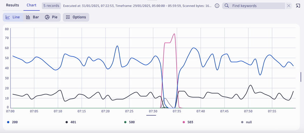

Web Request response code distribution
OK, there are a lot of them, and it would be really time-consuming to go through them all manually. So, instead, let's visualize the data by viewing the response codes as metrics. This enables us to quickly understand how response errors are distributed over time and how they affect each other.
To do that, follow these steps:
  1. Extract the response_code value from the istio JSON formatted log record by adding the following parse command to the query:
    | parse content, "json{int:response_code}(flat=true)"
    The command will convert the log record to a JSON object and extract the response_code value from it as an integer value. The extracted value is displayed as a new column in the results table.
  2. Create a metric from the field values by using the makeTimeseries command. Use the response_code as the metric and use a 1-minute interval for the series. The following DQL snippet can be used for this:
    | makeTimeseries count(default: 0), by: response=toString(response_code), interval: 1m
The final DQL query you’ve just constructed looks like this:
fetch logs
| filter k8s.cluster.name == "prod.cupid.cluster"
| filter k8s.container.name == "istio-proxy"
Click Run to execute the query and choose the Chart tab to view the results as a visualized chart.
The output looks like this:
Right-click on the query node in the query tree and rename the node “Response code distribution”

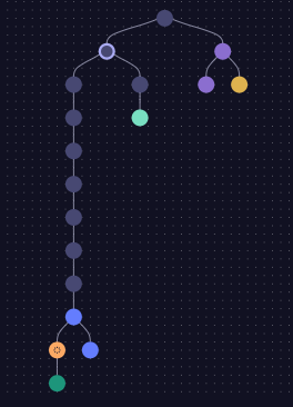

Yeah, well. OK, we still have a lot of requests to go through, but it seems that many of them result in either 200 (OK) or 401 (Unauthorized), which might not be that interesting for us at this point.
Let's change the color of this node to blue for future reference and filter the 200 and 401 events out to see if we have anything interesting left.
To set the node color, right-click on the active node, choose Color, and select the blue color.
To create the described filter, follow these steps:
  1. Hold down the Ctrl (Cmd for Macbook users) key on your keyboard.
  2. Choose the values 401 and 200 from the results table.
  3. Right-click on either of them and choose Filter.
    The following filter command will be automatically added to the query:
    | filter in(response_code, {200, 401})
  4. Add a not condition to the filter you created in the last step to exclude the records containing these records from your results. The filtering statement would look like this:
    | filter not in(response_code, {200, 401})
  5. Click Run to execute the query.
No results … Okay, let's set the node color to orange for future reference. Right-click on the node and choose the orange color from the color menu.

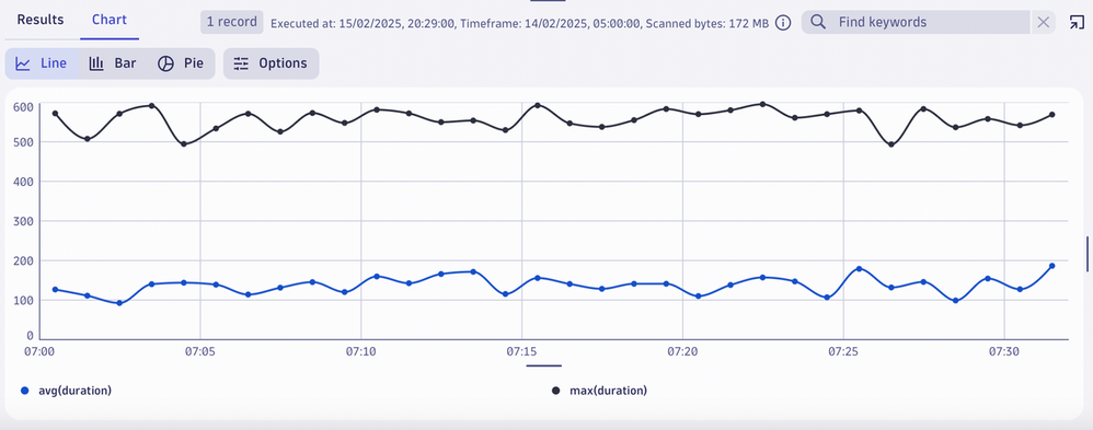

Let's check the response latency
OK, but maybe it is related to the requests that resulted in either 200 or 401. Let's analyze the response latency to see if something suspicious stands out. Let’s generate the average response time and maximum response time metrics from these log records.
  1. Navigate back to the blue node you created before
  2. Change the parse command to extract the duration from istio logs as well. You can do so by using the following DPL pattern instead of the previous one:
    json{string:response_code, int:duration}(flat=true)
  3. To extract metrics from logs, we can use the following makeTimeseries command as follows:
    | makeTimeseries {avg(duration), max(duration)}, interval:1m
The final DQL query looks like this.
fetch logs
| parse content, "json{string:response_code, int:duration}(flat=true)"
| filter timestamp < toTimestamp("2025-02-14T05:32:01.000000000Z")
The result visualized as a chart looks something like this:
Right-click on the node and name it “response latency chart”
Looking at the charts, nothing stands out. Everything seems to be within normal deviance thresholds. But what might have caused the incident?

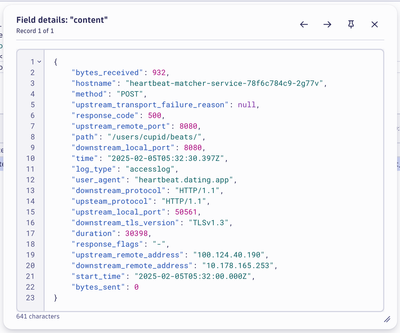

When are the events logged by istio?
When looking at the istio log sample in the “Background” section, we see two interesting fields in the logged event: duration and start_time. Since the log records contain the response and duration for the request, we can assume that the events are generated and logged at the end of the transaction after the response has been received. But what time does the timestamp represent, then?
Looking at the event, it seems that the timestamp field we used earlier represents the end of the transaction (when a request has received its response). This means that it is possible that our suspicious request has taken quite a long time to get its response and might appear in the logs after the first 503 event. To verify this theory, let’s look at the start_time field instead of timestamp and look for events based on that.

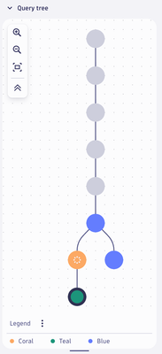

  1. Navigate back to the first orange node we created earlier.
  2. Modify the DPL pattern in the parse command so it will extract the start_date value as a new field using the following DPL pattern:
    json{int:response_code, timestamp('yyyy-MM-ddTHH:mm:ss.SZ'):start_time}(flat=true)
    This DPL expression will extract the response_code and start_time values from the JSON object with integer and timestamp types, respectively.
  3. In the filter command after the parse command, change the field name from timestamp to start_time. The final query should look like this:
    fetch logs
    | parse content, "json{int:response_code, timestamp('yyyy-MM-ddTHH:mm:ss.SZ'):start_time}(flat=true)"
    | filter start_time < toTimestamp("2025-02-14T05:32:01.000000000Z")
OK, cool, we got something! This time, the response is not empty! For some reason, there is a single event that resulted in a status 500 (Server Error)! You can look at the JSON payload closer by right-clicking on the content field and choosing View field details.
Let's change the node color to green and continue to look deeper into the request.

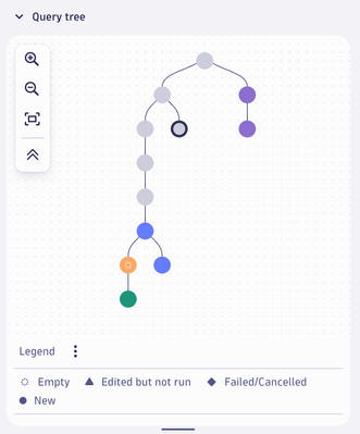

By now, your query tree should look something like this:

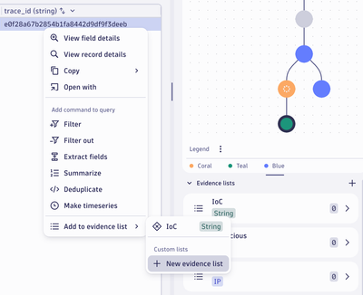

Let's try to find out what happened during this request in our systems. The easiest way to do that is to use Dynatraces' Distributed Tracing, which creates spans and traces for every request that it is monitoring. Luckily, we have trace_ids attached to our log events.
First, let's save the trace_id from the suspicious error 500 events as evidence. You can do so by right-clicking on the trace_id value in the results table and choosing Add to evidence list → Create a new list. Name the list as “errors trace”. Now we can use this trace_id to create filters on any query node.

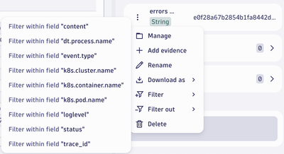

To start searching for the log records matching this trace_id, follow these steps:
  1. Navigate to the first node at the top of the query tree where we had all the logs from our k8s cluster.
  2. Add a filter command to the DQL query by clicking on the “errors trace” Evicende list menu, choose Filter for, and choose Filter within field “trace_id”.
The DQL query you’ve just constructed looks like this:

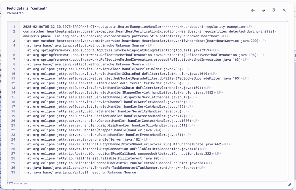

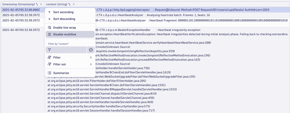

A new branch is created for the first node, which has all the events from this trace so we can dig deeper. Set the node color to purple so we can reference it later.
Enable the multiline mode for the column from the Column menu at the top of the results table to simplify reading the logs. This will give a better overview of multiline logs, such as stack traces and other longer and structured logs.
Another good option for viewing multiline logs would be to open Field Details view from the fields context menu and navigate between the log records using the arrows on your keyboard.
Rename the node to “Failing request“ and continue analyzing the results.
When we look at what a POST request logs should look like in the “Background” section, they aren’t quite the same as we see here. Especially interesting is the stack trace part, which is visible in the trace. It seems we have encountered some heartbeat irregularities, which has thrown our system into an unexpected state.

  2. Add a filter command to fetch logs only from the same pod by right-clicking on the k8s.pod.name value and choose Filter for.
  3. Add another filter command to see only relevant logs from the same container by right-clicking on the k8s.container.name value and choose Filter for.

The results provide some interesting information. It seems that our service received a shutdown command (graceful, I might add), and the application restarted itself.
 Commencing graceful shutdown. Waiting for active requests to complete
But why? Has our system been hacked? Has a hacker stopped or restarted our system? Has the Kubernetes control plane lost its mind? Is it the Aliens? Let's see what we can find from other logs!

Let's see what our Kubernetes cluster did at that time. Fortunately, we’re collecting those logs as well. To see the k8s console logs, follow these steps:
  1. Copy the last two lines containing the filter and sort commands from the current query.
  2. Go to the second gray node in the query tree, where we aggregated all the log sources and what we called “Log sources”.
  3. Remove the last line that contains the summarize command.
  4. Right-click on the “Linux System” value in the dt.process.name column and choose Filter for to fetch only the k8s plane logs.

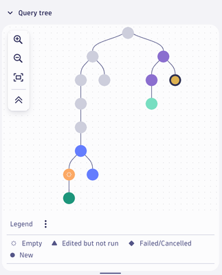

The query tree by now should look something like this:

  5. The requests that came in during the restart resulted in a response code 503 (service not available).

The results don't reveal much in the Security Investigator. Still, luckily, we can use Notebooks to format the findings in a more meaningful way and use it to share the outcome with our stakeholders! But first, give the node a new color of Gold and rename the node to “Heartbeats“.

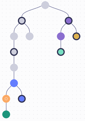

The final query tree looks like this:
Report your investigation results in Notebooks

  • the second gray node to show the log sources we analyzed

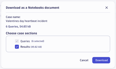

    ed384319-5e1b-48c0-aab7-07dfc160ac09.pnged384319-5e1b-48c0-aab7-07dfc160ac09.png2. Right-click on the nodes and choose Download nodes as → Notebooks document.
    3. Check the Results checkbox to include results in the Notebooks document.
    4. Click Download, and you’re done!

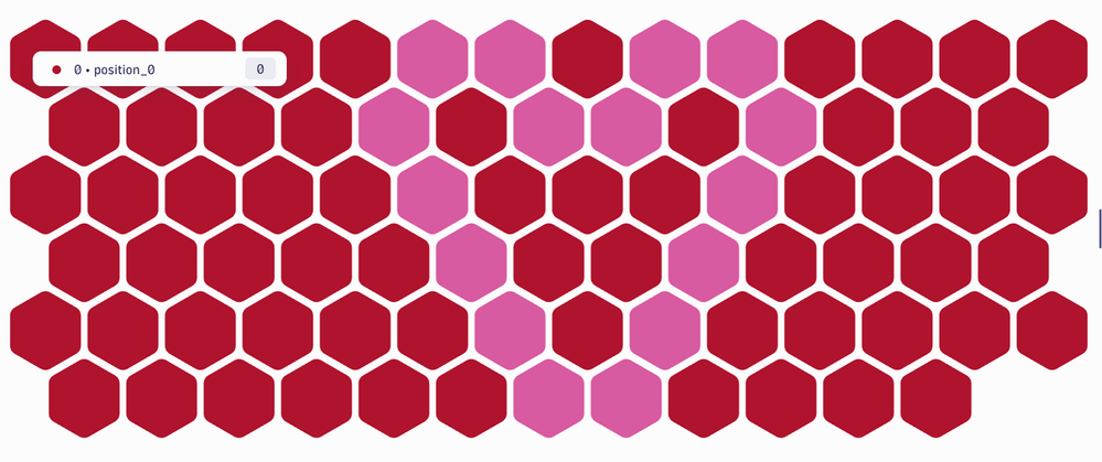

But currently, let's focus on the last section that contained our Heartbeat Fragment. Let's see if we can find a suitable visualization for the fragment.
  1. Open Heartbeats segments Options.
  2. Choose Honeycomb visualization.
  3. From the color palette, choose Fireplace.
Your request that made your service skip a heartbeat (or a few) looks like this:

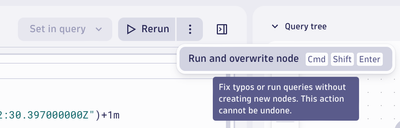

You can either choose this option from the "Run" menu ("three-dot menu" next to the Run button) or use the keyboard shortcut Ctrl + Shift + Enter (Cmd+Shift+Enter for macbook users).
