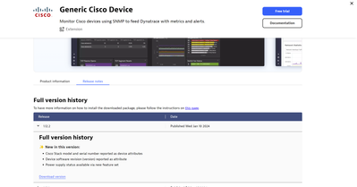

Hi @JohanZuleta ,
I think you can try to add them to the extensions and test the extension as you will find all the OIDs for the extension available in extension.yaml file, you can download the extension from Dynatrace hub and you will find all available OIDs and metadata in extension.yaml
