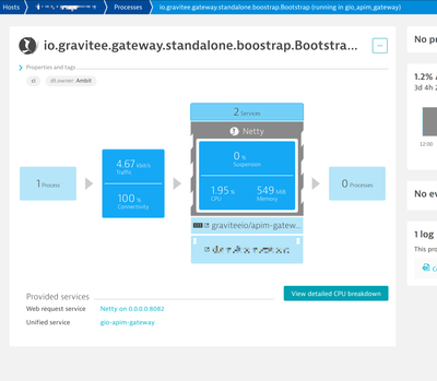

The Gravitee.io API gateway is not a directly supported technology by OneAgent. Without support you are unable to see any processing within the API gateway and traces stop at the API gateway. Luckily, there is a trace plugin for OpenTelemetry at https://www.gravitee.io/plugins/gravitee-tracer-opentelemetry .
Steps to get this working:

13:58:09.943 [graviteeio-node] [] INFO i.g.node.tracing.TracingService - Tracing support is enabled with tracer: name[otel]
Just a few notes:
